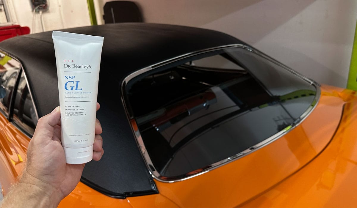

In Part 1, 1970 Plymouth Superbird – Paint Correction with Dr. Beasley’s, I shared the process I used to do all the paint correction and final polishing to create a true show car finish on the Superbird’s intense Vitamin C paint color. The fact of the matter is, I actually did Part 2 (the glass polishing) first, followed by the paint correction. During this time, we were still testing different formulas for Dr. Beasley’s Nano Surface Primer GL, their new polish for glass. For this reason, I could not share the glass polishing aspect of this project until AFTER the Dr. Beasley’s NSP GL become public knowledge, which it is now — you can buy it right here!
Down below, you’ll see pictures of 3 different beta formulas I was testing for Jim Lafeber and this was actually before I was offered the position of CEO – Chief Education Officer for Dr. Beasley’s. The timing was 100% coincidence. I was asked to remove the scratches out of the back glass window on the 1970 Superbird at the same time Jim was creating his new glass polish formulation with its patented abrasive technology.
The timing of all this is almost supernatural! And the best news is, the final and approved formula for the new glass polish saved the day, or more specifically, saved the glass! I’ll tell the story below, so if you’re ever in a position where you have a super cool car that’s 100% finished with exception to an original and super rare back window filled with deep scratches — well, here’s your prescription for restoring that glass back to factory new condition.

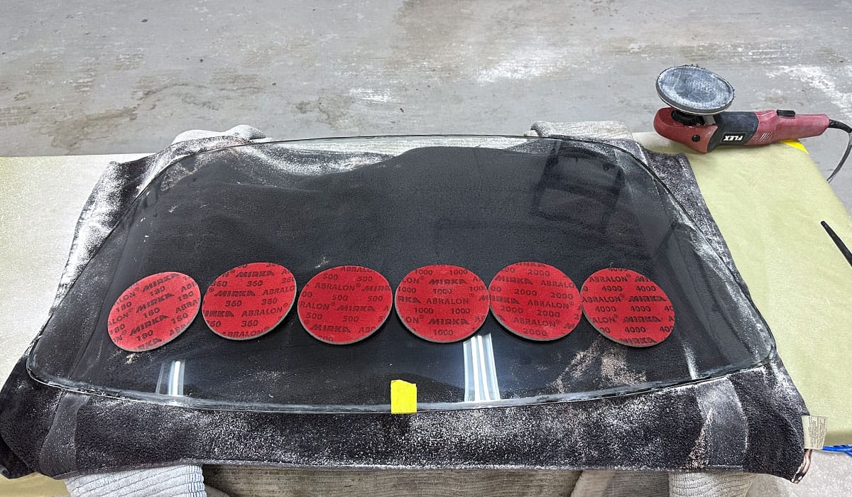

After sanding the glass completely flat with the first #180 grit disc, I felt this first disc was worn out and wasn’t sanding as faster as it did when it was new, so I switched to a second #180 grit disc and continued sanding until all but one tiny scratch remained – you’ll see it in the pictures below.

#4000 will be the last sanding or refining step. I didn’t have any #3000 discs or I would have used them after the #2000 sanding discs. Regardless, the #4000 did such a great job of refining the #2000 grit sanding marks the glass basically looked polished.
Hmm… did I leave my car keys in my car with the doors unlocked? Seriously, look at the glass? Look how it’s starting to look fairly clear?
Some experts might say there’s no need to do the last 2 sanding steps. They would recommend to start polishing after the #1000 grit sanding step and I agree they are correct. You or I could start the polishing process after sanding with a #1000 grit sanding disc but not this time. This isn’t some glass window you can get at the local Safelite glass company — this is a rare bird. I’m going to refine and then refine again – ANYTHING that gives me the best chance of working all the way through the process to success – not a broken chunk of glass I’ll have to show the owner of the car.
I beg to differ and can prove these higher grit sanding discs do in fact sand or abrade glass and this means they REFINE the previous sanding disc scratches to a more shallow and uniform scratch pattern that will be easier, faster and safer to polish-out.
Look at the face of the sanding disc. See the whitish color? That’s GLASS particles the #4000 grit sanding disc sanded off the glass thus refining #2000 grit sanding marks to more shallow #4000 grit sanding marks and my nylon detailing brush is going to prove it.
See the sanding disc cleaning up? #4000 grit sanding discs do sand glass when used in progression like I shared here. Of course, #4000 is never going to work as the first or initial cutting disc as glass is too hard.
Sanded with #180 grit
Sanded with #4000 grit – no polishing yet – HUGE difference!
I machine sanded the entire glass window using two #180 grit sanding discs and focused on this area without overdoing it, which could cause a visual imperfection. At some point I said to myself, “It is finished.” And below you can see, just as I said previously, if you don’t remove the defect during the first or initial cutting process, it’s very likely it will be there at the final process.
Pretty insignificant considering the overall look of the glass before we started and so far – no mistakes – no cracked glass.
Look closely… do you see any sanding marks in the glass? Not really. The more you refine, the faster, easier and safer it will be for the polishing step.

Next step – machine dry sanding with #360 grit
When sanding anything with the intentions of following the sanding process with some type of polishing process to remove the sanding marks – sanding out to a very high grit is best as it makes the polishing process faster and easier. This is true for car paint and boat gelcoat, and even MORE true for glass. With a great polish, the right pad, tool and technique, an experienced person can stop sanding after #500 grit and believe it or not, remove their sanding marks. I’ve done it.That said, when it comes to some other guys’ muscle car, I’m going to re-sand and thus refine my sanding marks multiple time in my effort to make the polishing process as easy as possible, as fast as possible and as safe as possible by keeping temperatures low. The deeper the sanding marks you must remove, the longer you must polish, therefore the more you risk overheating the glass. The more shallow the sanding marks, the less polishing required and thus the less heat generated.
Hmmm…. I wonder what’s for dinner tonight?
Clean the face of the sanding disc often
While sanding, if you lift the spinning disc off the glass surface for a few seconds, most of the glass polish residue will spin off the disc, but not all of it. For more thorough cleaning of the face of the disc, use a nylon detailing brush or even a toothbrush against the face of the sanding disc as you run the polisher and this will remove about 95% of the glass dust that builds-up on the face of the sanding disc.
Next step – machine dry sanding with #500 grit
Hmm…. I wonder what’s on TV tonight?
Next step – machine dry sanding with #1000 grit
Next step – machine dry sanding with #2000 grit
Hmm… did I leave the oven on?
(Apologies, my mind tends to wander when buffing or typing)
Next step – machine dry sanding with #4000 grit
For the experts
Some might say #3000 and #4000 don’t really sand glass.
Look at the before and after difference?
One tiny scratch remains…
Almost looks clear again?
I used a total of 7 sanding discs – one of the #180 grit discs not shown.

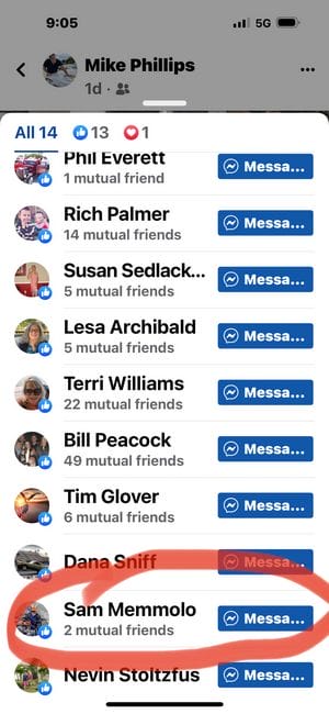

Interesting side note – Sam Memmolo “Likes”!
After sharing some pictures of the glass sanding project online, the pictures received a lot of “Likes” including a Like from my old friend Sam Memmolo! Sam, along with Dave Bowman, are two guys that are credited with being the guys that STARTED the entire car guy TV shows. Sam and Dave started and starred in, Crank & Chrome, Shade Tree Mechanic, Two guys Garage, and Motorhead Garage, just to name a few and some of these shows continue on with new hosts, but it was Sam and Dave that started it all.
Here’s a screenshot from my phone.
Here’s yours truly on the set of Motorhead Garage with Dave Bowman, (on my left), and Sam Memmolo on my right)
Sam and Dave are the kind of guys that have forgotten more than I’ll ever know so to get a “Like” from Sam for my lowly glass polishing project is a real complement – thank you Sam!
