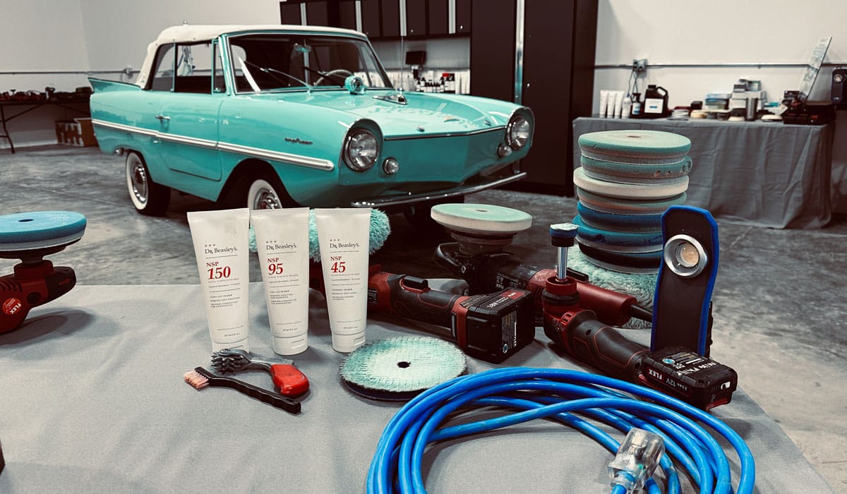

Here's most of what we'll be using for the operation.
Beautiful car but she'll look even gooder after we fix the back window so the owner can see out of it. :)
