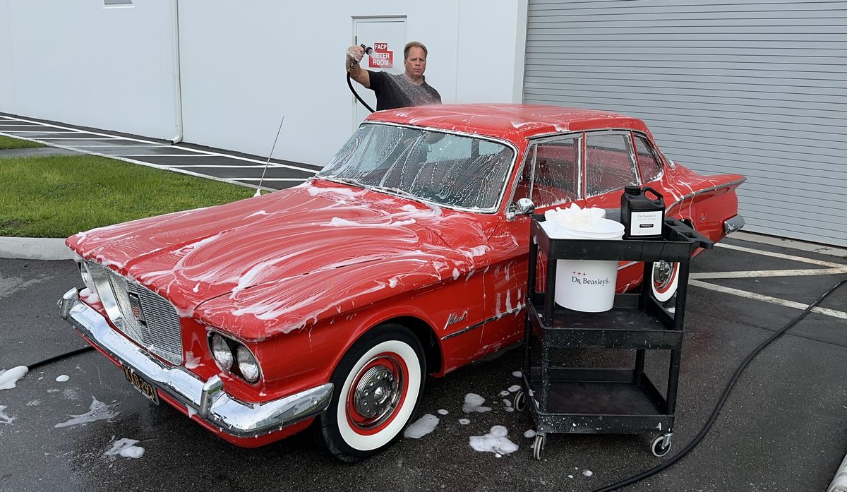

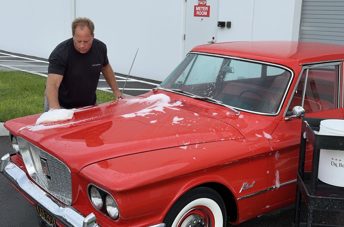

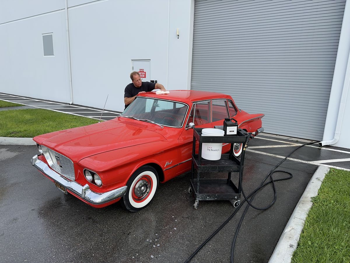

Here's the backstory on this car. It was fully restored about 15 years ago. It's one of the nicest complete restorations I've ever seen EXCEPT the paint. The paint is horrendous, which you'll see in the pictures below. Besides being full of swirls and scratches, the Baggie Test revealed a uniform layer of contamination over the entire car including all the glass and chrome trim. While I don't normally wash retore and original classics, due to the high level of contamination, I decided the best approach would be a full wet-wash followed by doing the mechanical decontamination while the car was wet using a clay detailing mitt.
