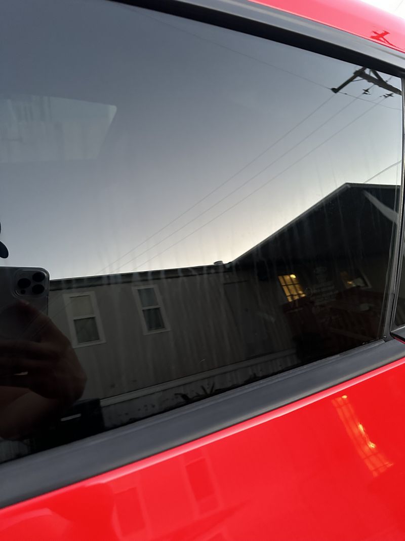

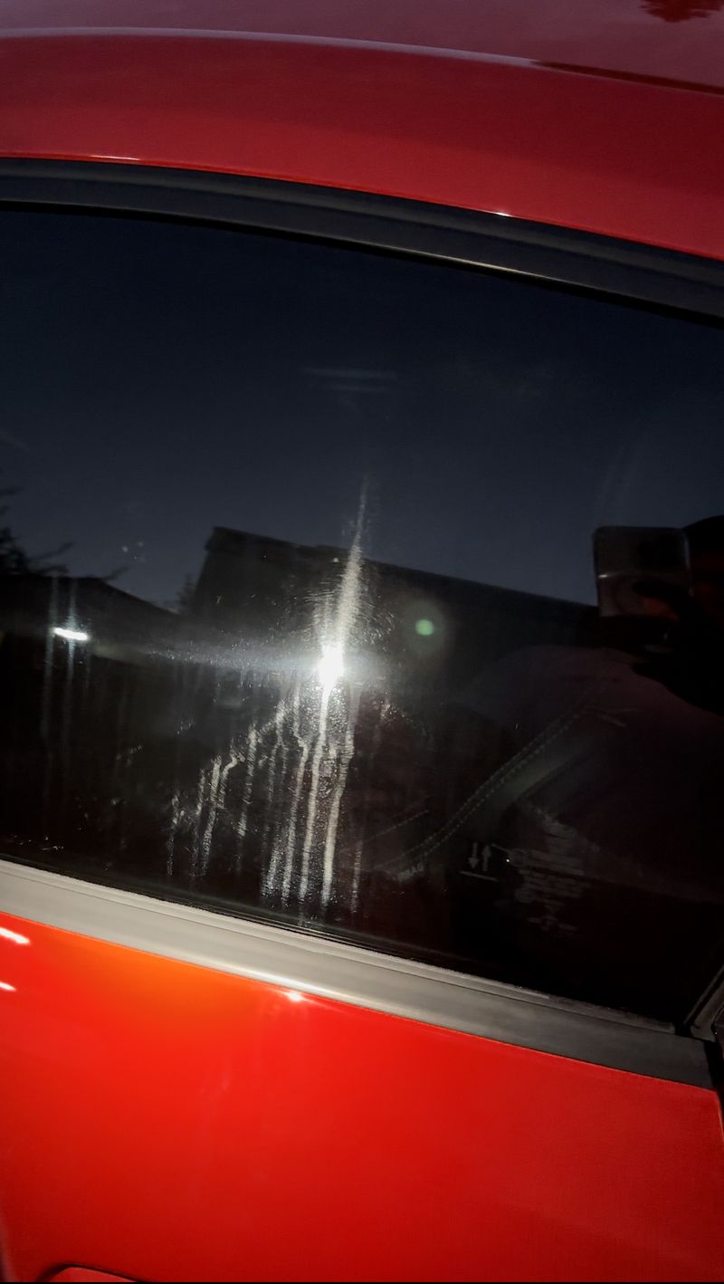

A real common problem with older cars is that the glass windows tend to have a lot of random swirls, scratches, water spots and also wiper marks in the windshield. It’s actually a lot more common than most people think.
When people look at classic cars, antiques, streetrods and muscle cars, much of the time the focus is on the finish quality of the paint, the engine and/or the interior. Cars from before the 1980s had real style, and this is why people enjoy looking at them at car shows! They look different and I would say better than all the mundane daily drivers that now fill our busy highways, city streets and parking lots.
If you don’t purposefully look and even inspect the condition of the glass, often times you won’t see the multitude of swirls and scratches in the glass. These below surface defects can also be difficult to see without good lighting. Me? I always inspect the glass on older cars because experience tells me chances are good that not only does my customer’s car need the paint polished, it needs the glass polished too.
I hear ya… polishing scratches out of glass is a LOT more difficult than polishing scratches out of car paint or even gelcoat like you find on a lot of boats and motor homes (Besides teaching car detailing classes, I also teach boat detailing classes, so I’m pretty familiar with removing scratches out of car paint, gelcoat and glass). There’s a couple of key factors that will determine your success or failure when it comes to machine polishing to remove scratches out of glass and the good news is, you can do it and I’ll show you how!

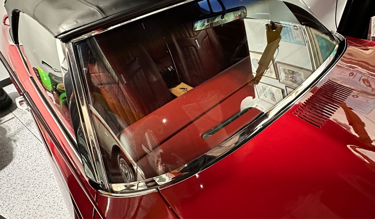

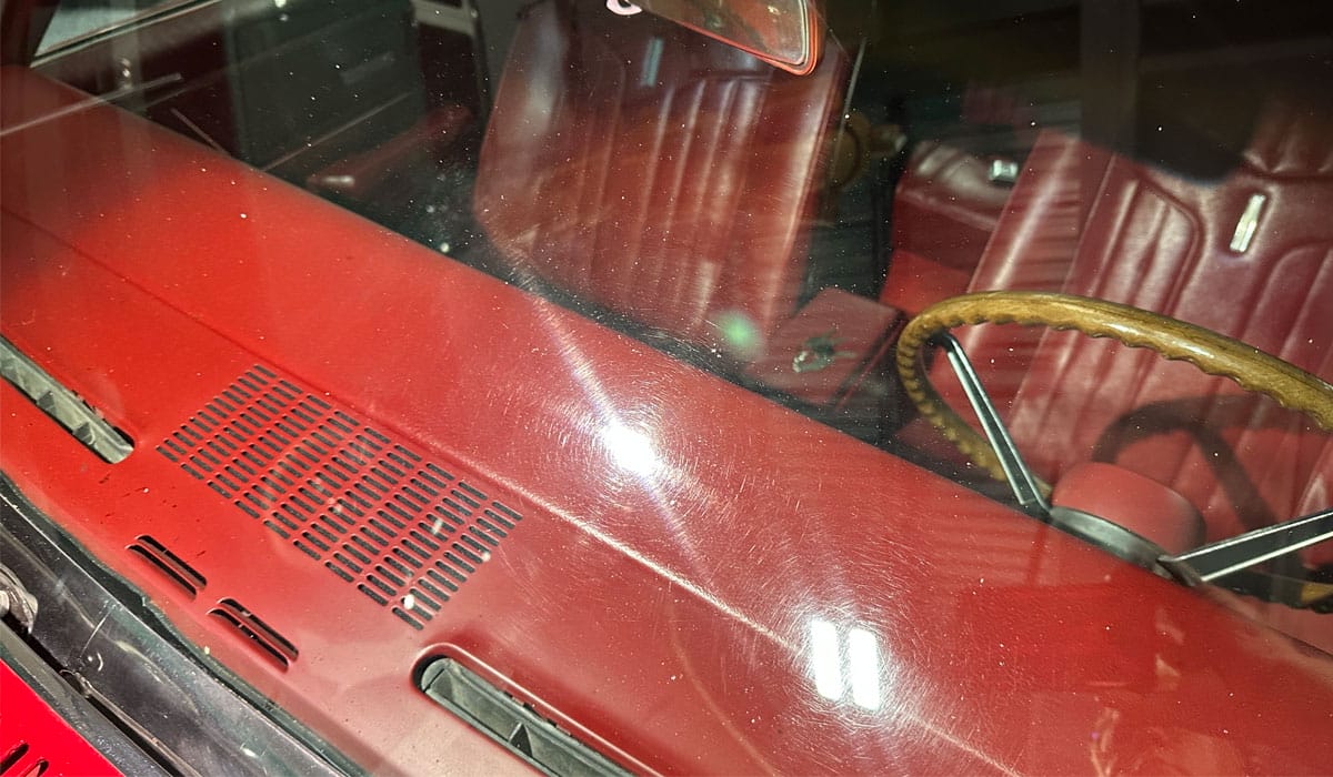

From this picture, to most people, the car looks great as does the glass. But in reality, both the paint and the glass are filled with scratches. I’ll fix the glass first and then I’ll do all the paint correction and ceramic coat the paint.
Mass swirls and scratches in a car’s windshield create a safety risk. Anytime the sun is shining on the windshield, the swirls and scratches will create glare and make it difficult to see clearly through the glass. This is even more pronounced during early morning and late afternoon driving when the sun tends to be lower in the sky.

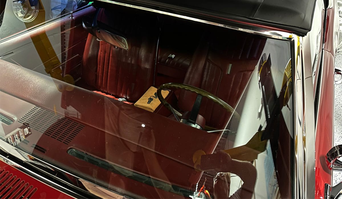

Below, you can see the scratches in the driver’s side of the windshield using overhead lights.
Note: If you’re new to my writing and video style, I’m known for documenting the heck out of before and after. I’m confident in the products I use for my personal work and teach in our detailing classes and I want you to be confident also.
Below you can see a arc-shaped scratch, this is a wiper mark – at some point the steel wiper arm came into contact with the glass and gouged it in a pattern that mimics the path the wiper blades travel over the windshield.
I purposefully took pictures to show the swirls and scratches are not only all over the entire windshield but also in the CORNERS. This is where a 3″ rayon glass polishing pad comes in real handy as the larger circumference of larger pads make it difficult to polish into the corners.
As you can see in the pictures below, the swirls and scratches are throughout the entire windshield.

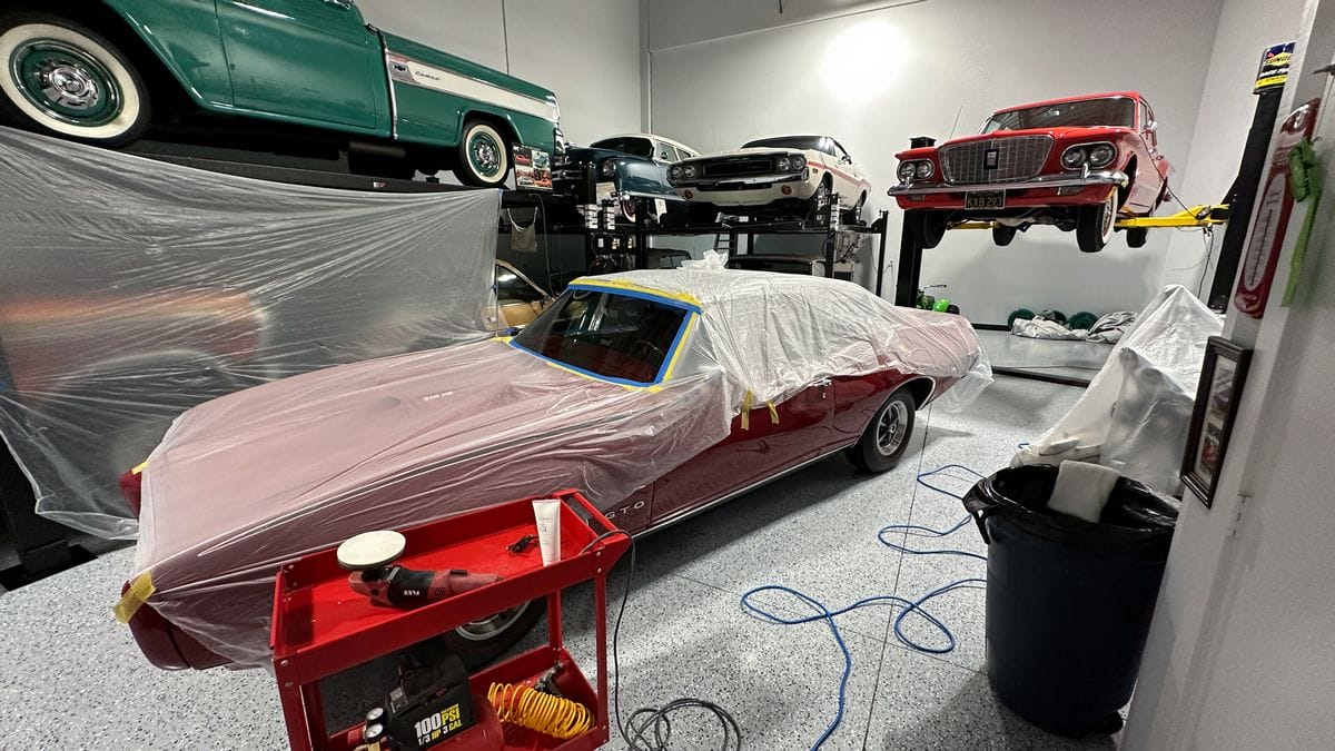

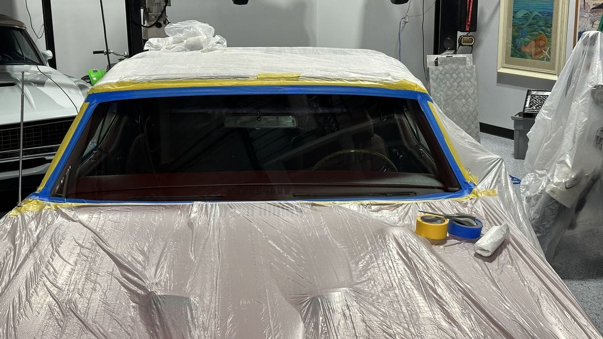

Here’s the deal, it’s easier and faster to cover a car with a plastic drop cloth by first placing tape all the way around the window you’re going to polish. Next place the plastic drop cloth onto the car and then cut out the section of plastic where the windshield is AND THEN tape the cut out section of the plastic drop cloth the masking tape already in place around the windshield.
When placing tape around the windshield, place the tape about 3/8th of an inch ONTO the glass and SECURE or PRESS DOWN FIRMLY (like your life depends on it), so there’s great attachment strength between the the glass and the tape. This is important because as the combination of polish and water are slung into the tape it can loosen and you’ll never get it to attach securely again.
This means the polish/water slurry will get into, under and behind any decorative trim (like on this 1969 GTO) and also onto any rubber window gasket material as well as around the sides of the window and at the bottom of the window. On modern cars, there’s usually a lot of plastic cladding around the wiper arms. I prefer to cover and protect the wiper arms, blades and plastic cladding when buffing glass on modern cars. Dr. Beasley’s NSP GL will not stain these areas but it’s faster to clean up if you protect these areas in the first place before starting.
Because this car has a vinyl top and I’m not doing a normal water hose and bucket wash after the glass polishing, I’m placing an extra strip of tape onto the chrome trim and then onto the vinyl top. Like the saying goes, an ounce of prevention saves hours of clean-up.
Here I’ve unfurled the roll of plastic drop cloth and next I’ll start attaching the plastic to the car.
See how I’ve attached and pulled the plastic tight.
IMPORTANT – Start your cut at the top of the windshield. Cut along the tape line.[/B] Then cut both sides and LASTLY cut along the bottom of the windshield. After cutting out the section of plastic in front of the glass windshield, next tape the edges of the plastic to the tape frame you already have in place.
I’ve done this a LOT in my life and for the value of this car and my time, I have a large chunk of plastic drop cloth from another project and I’m going to attach it to the roof and then bring it all the way down the back of the car.

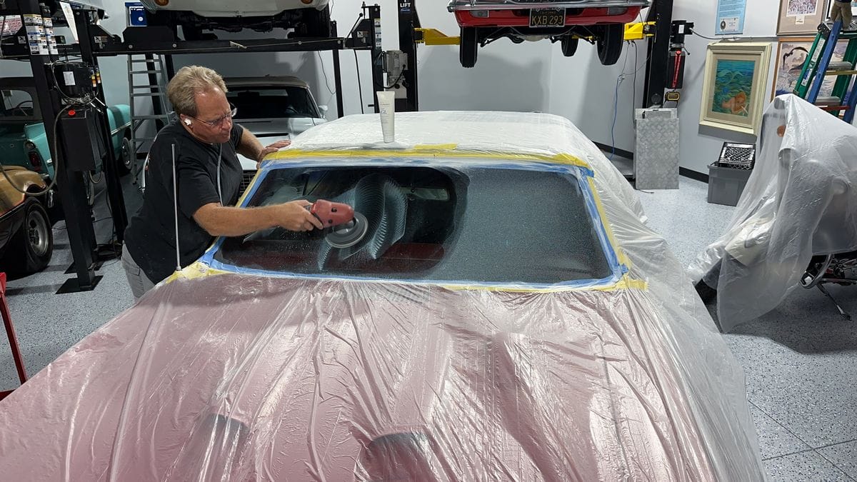

It might seem like overkill, but I use a high speed rotary polisher for glass polishing and when you’re buffing for long periods of time using a rotary, the centrifugal force created by a spinning pad tends to sling the wet water and polish slurry everywhere. Behind the plastic is a 1978 Ford Bronco Custom, of which at the time of typing this article, I’ve also polished the driver’s side window and in front of it is a 1978 AMC Pacer, with the original paint and scratches in the glass, that you’ll see in a future video and write-up.
Might seem excessive, but this is how I do it. I’m now comfortable with how well everything is covered and protected. It’s time to get busy.

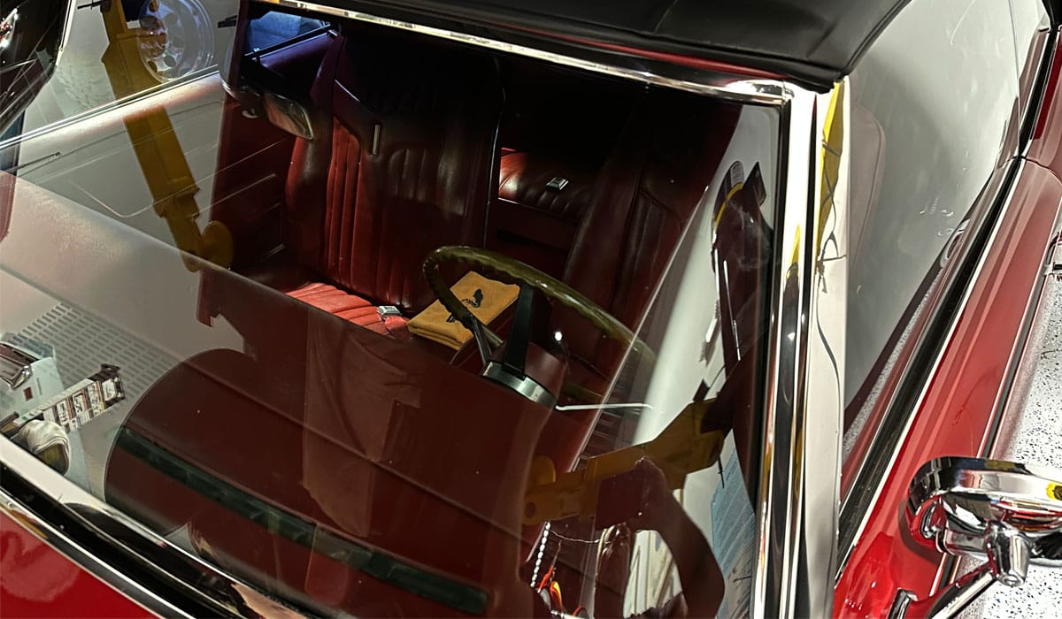

The passenger side glass window has a LOT of scratches running in straight lines from top to bottom where the glass has dragged against the inner window frame over the decades. I’ll do my best to clean this glass up after the windshield.
Same best practice – I’ve done a very thorough job of framing the window in tape and then taping the plastic to the tape frame.
The rotary polisher I’m using is the FLEX PE14-3 125 with a high RPM speed setting of 3700 RPM. When it comes to glass polishing, besides the abrasive technology and the rayon pad, speed is your friend. Optimum RPM after spreading the polish out is approximately 2200 to 2600 RPM and this FLEX rotary handles this requirement easily. FLEX makes the best automotive polishers on planet Earth. I normally buff glass at 2600 RPM, which is around the 4-5 setting on the speed dial.
And just to document, yest this is the same car and windshield as shown in pictures above.
Before starting, attach your foam interface pad to the face of the backing plate. Some interface pads have holes for vacuum applications, but any type of interface pads, holes or no holes will work.
What’s important is the thick foam core. This makes polishing easier on you and also helps to maintain 100% contact between the rayon glass polishing pad and the glass you’re polishing. Keep in mind most windshields have a curve to their design, that’s where the cushion and flexibility provided by the foam core comes into play.
Always do your best to center both the interface pad and the rayon glass polishing pad onto the backing plate.
For the initial application when starting out with a clean DRY rayon glass polishing pad, apply a circle of product onto the face of the pad. After the pad breaks in, you can reduce the amount of product to a few nickle sized drops.
Mist some clean water onto the glass before polishing, and then during polishing, when possible, have a buddy present to mist water while you polish and switch back and forth to prevent fatigue.
If I wasn’t writing this article and wanting to show you the power of the Dr. Beasley’s NSP GL Glass Polish, I would NOT have placed a tape-line down the side of the windshield. I did this in order to get before and after pictures after polishing for only 10 minutes. The results are impressive, but will be even better after I take my pictures, remove that strip of tape and get down to business.
There are literally millions, if not billions of splatter dots on top of the plastic on top of the car hood. Same goes for the roof, the back of the car and even the vertical panels. It’s so much more rewarding at the end of the job to ball up the tape and plastic than it is to wipe off all the splatter.
Just to note, you must use a rayon pad to do this type of sub-surface glass polishing. Foam pads, wool pads, microfiber pads simply do not work. The good news is, for a windshield, you really only need on pad. And after use, you can hand wash it in a sink and then place it somewhere flat and clean to air dry for use the next time you need to do some glass polishing.

No buddy for me
Note that in the below pictures, I didn’t have a buddy. But I’m a machine, so I powered through the old fashioned way – doing the job by myself. My strong recommendation though – try to have a buddy, even if it’s your wife, girlfriend, kids or neighbor.

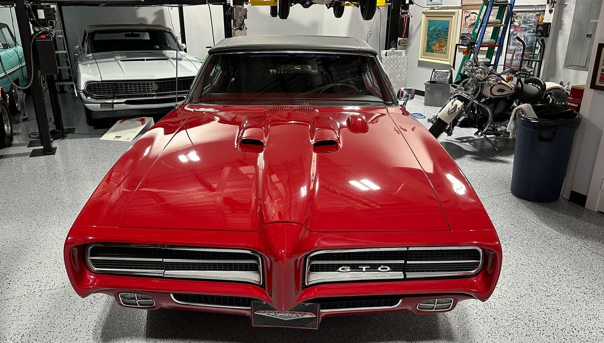

Demo car – 1969 GTO Convertible

Mass swirls, scratches and wiper marks
3″ Rayon Pads
Passenger side windshield
Frame the window frame with masking tape
IMPORTANT
More plastic
BOOM! This is how I cover and protect cool cars like this GTO before polishing.
This is the second windshield I’ve polished out in this private man cave collection of cars and as such, I have already covered up a nearby vintage, restored Harley Davidson Motorcycle. The last thing I want to do is take a toothbrush to the intricate and complicated design of a Harley Davidson Motorcycle and especially the spokes and fins on the engine.
More cover and protection
This is how I roll!
Ready to start glass polishing!
High speed FLEX rotary polisher
Here’s our hero product – Dr. Beasley’s GL Nano Surface Primer Glass Polish
Pre-polishing set-up
Getting busy… and yes, that’s one handed rotary buffing
