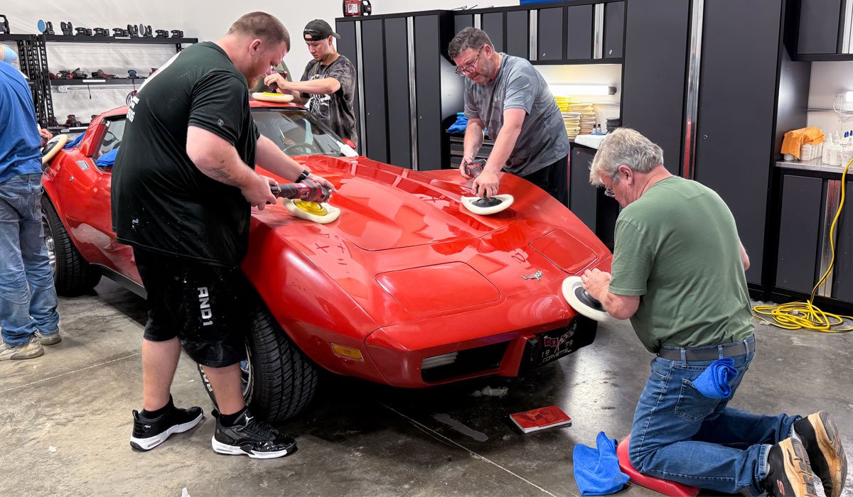

Up first are Eugene and Doug. Eugene is using the RUPES rotary polisher while Gene is using the FLEX rotary polisher.
See the Nr. 00002 on the sticker?
This is the Number #2 FLEX PE-150 corded rotary polisher given to me by Bob Eichelberg, formerly with FLEX, retired now. Thanks Bob!

Here's Eugene, still working on the passenger side, while Nelson, who travelled all the way from Bogota, Columbia to take this class has now joined us and is working on the driver's side.
Switch Sides
You can see Nelson and Eugene have switched sides. Running a rotary polisher on an glass windshield at an ANGLE - stresses your deltoid muscles as you use your arm to press the rotary against the glass. A trick I use and teach is to switch sides and use the other arm for a while and if you feel your muscles getting tired, switch again. When I work by myself, I do this same thing with two workstations set up on each side. This way I can simply move from side-to-side without having to drag my tools, pads and towels from side to side.
Juan has joined us next. Juan came all the way from Kentucky to take this class.
