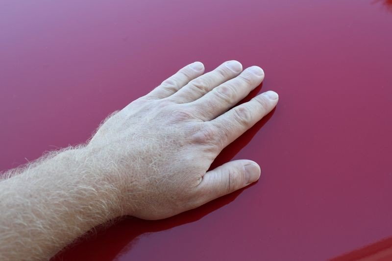

When using a rotary buffer, periodically check the temperature of the paint by placing the palm of your hand flat on top of a section you just finished buffing, like this,
If the paint feels warm, even close to hot, BUT it's not so hot that you jerk your hand away, then it's in a temperature range that's safe to buff.
If you you place your hand on the paint and your Fight or Flight instinct takes over an you find yourself jerking your hand away from the surface at the speed of light, then the paint is too hot and you should stop buffing that section and allow the paint to cool down.
