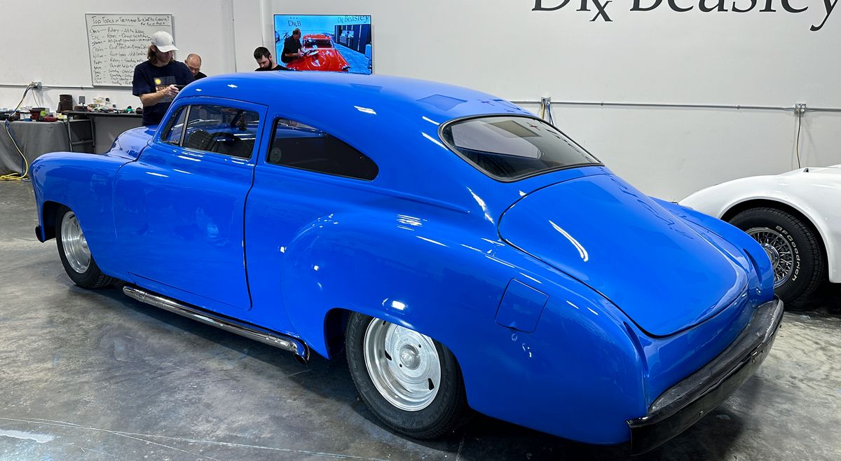

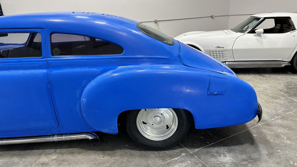

I can appreciate any person that takes on the huge task of restoring a car, or in this case hotrodding a car and this includes learning how to paint a car for the first time. The paint on this car had a lot of orange peel and dry spray plus surface texture like graininess. I'm so impressed with the class as they completely turned this paint job around and the final results are nothing short of phenomenal.

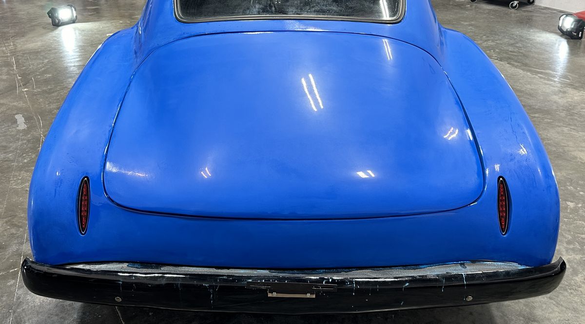

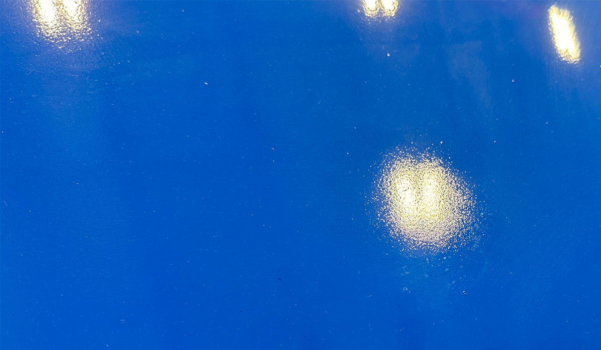

Extreme Orange Peel
Extreme Dry Spray
Orange Peel - Dry Spray - Surface Texture

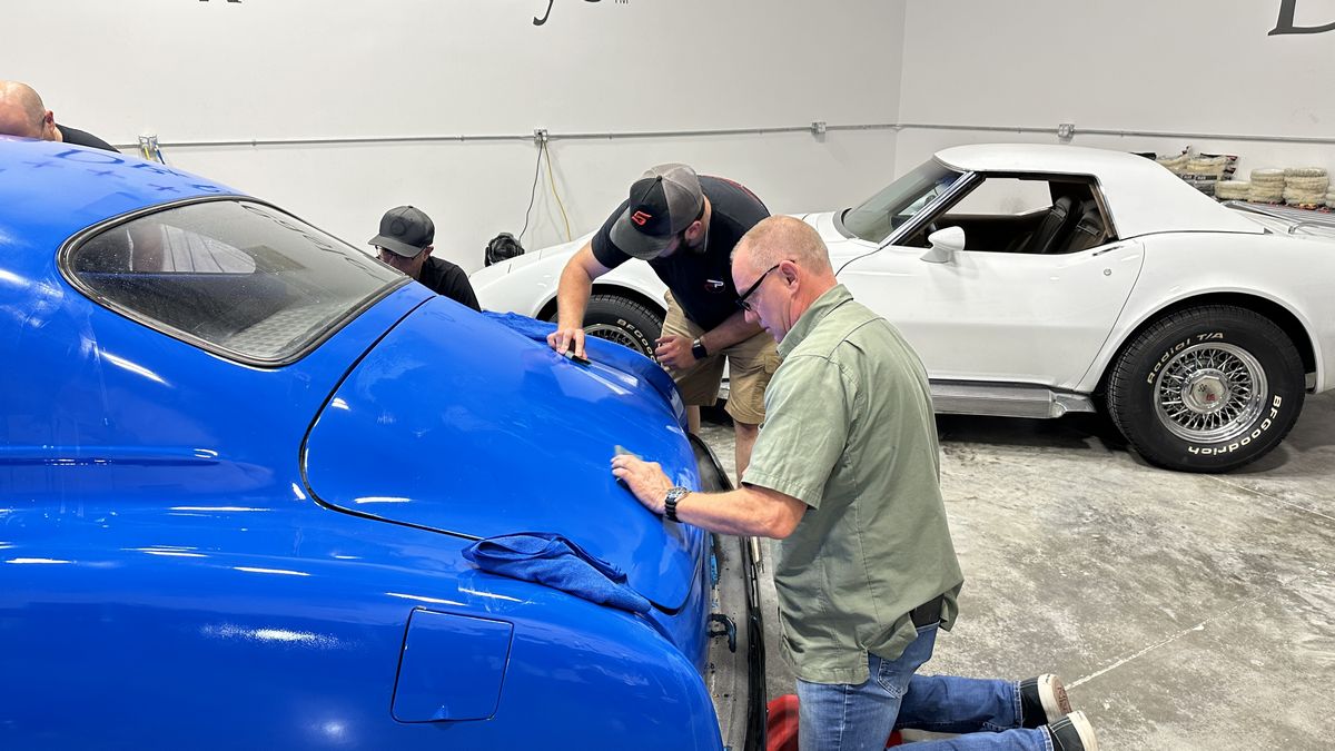

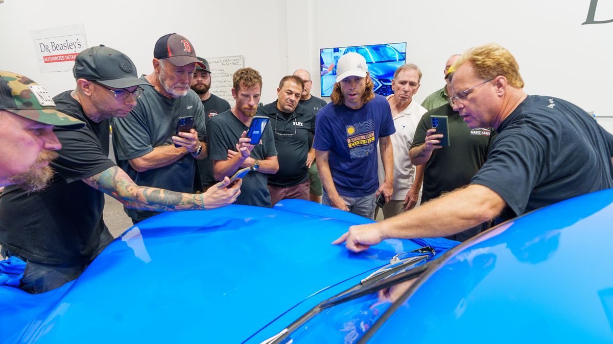

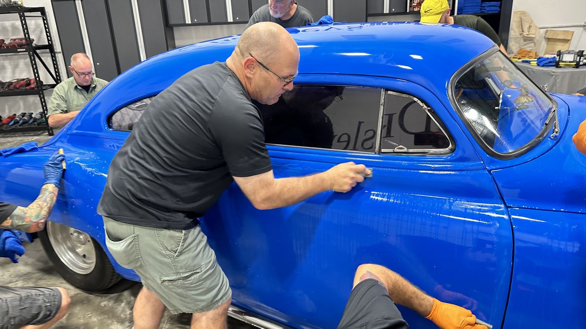

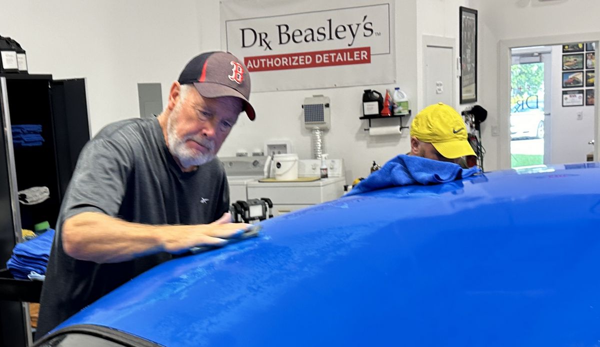

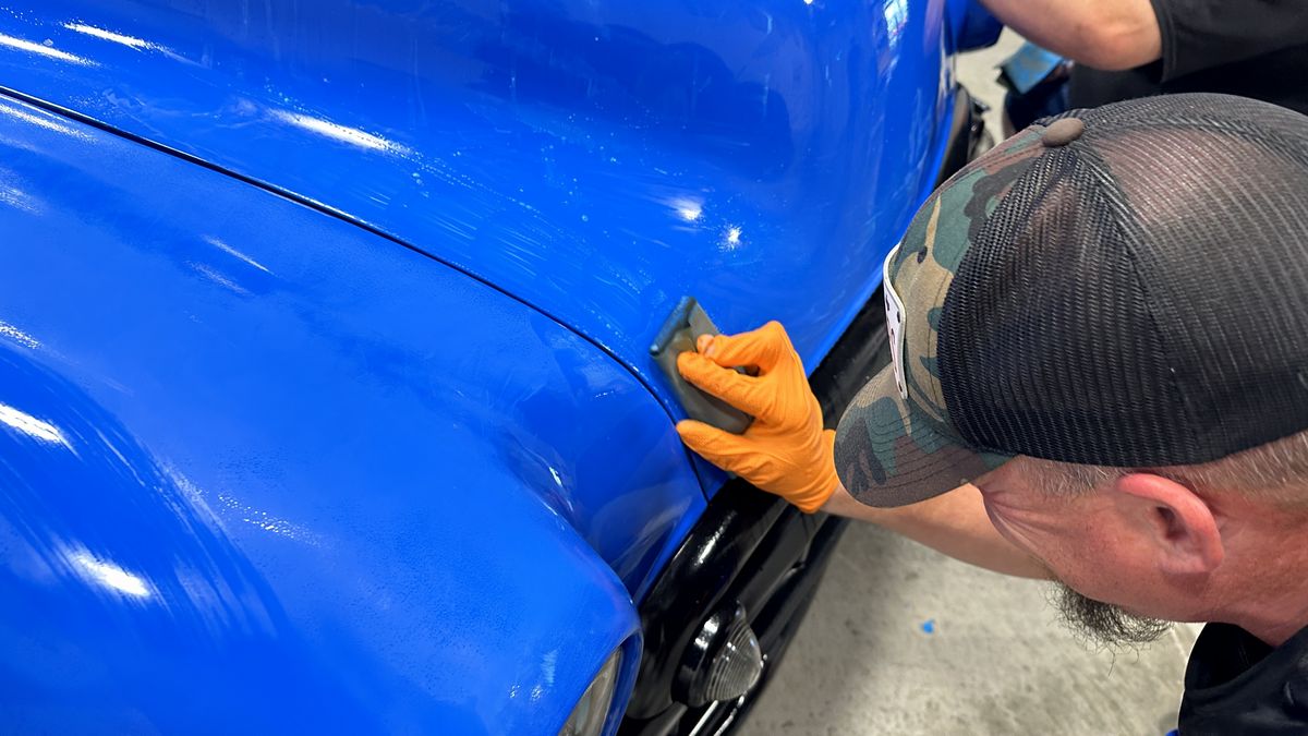

Hand Wet Sanding
First step for this car is to learn how to wet sand by hand. For this class session, I share tips and techniques for sanding not just the easy to sand larger sections of paint, but how to hand sand around edges and raised body lines. For this first sanding step, we'll be using the Nikken brand of Finishing Papers. Note these are not sand papers, they are FINISHING papers, super high quality unigrit particle size and distribution over the entire face of the sheet of sandpaper. Been using and showing this brand for hand wet sanding since 1987 - that's 38 years.
Continued....
It's GO TIME!
After some technique demonstrations plus some question-and-answer time, I turn the class loose to sand down some other dude's streetrod. According to my 100 Year FLEX Anniversary Watch, given to me at Automechanika in Germany, by the President of FLEX, it's 10:30am and my class is on their feet sanding on the real-deal.
Continued....

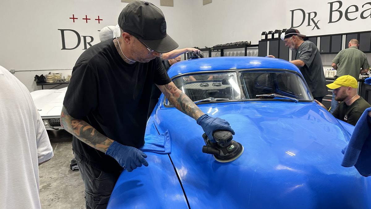

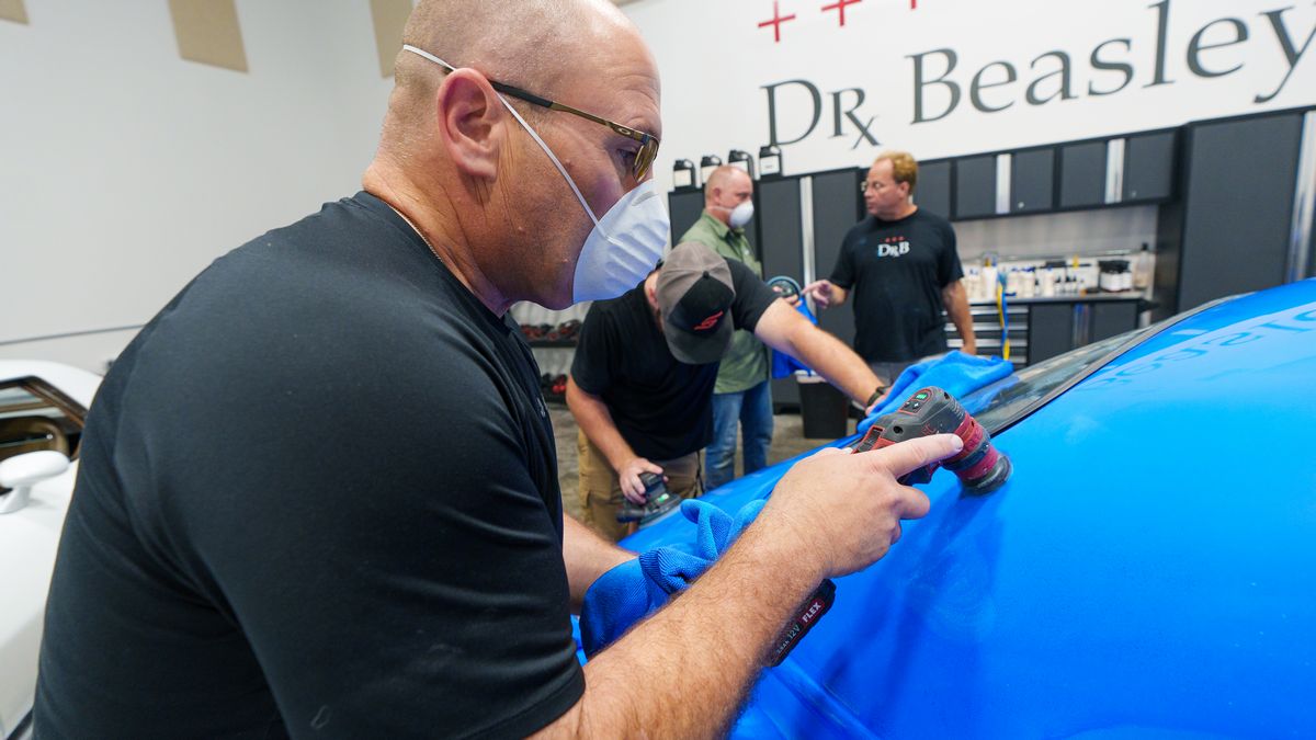

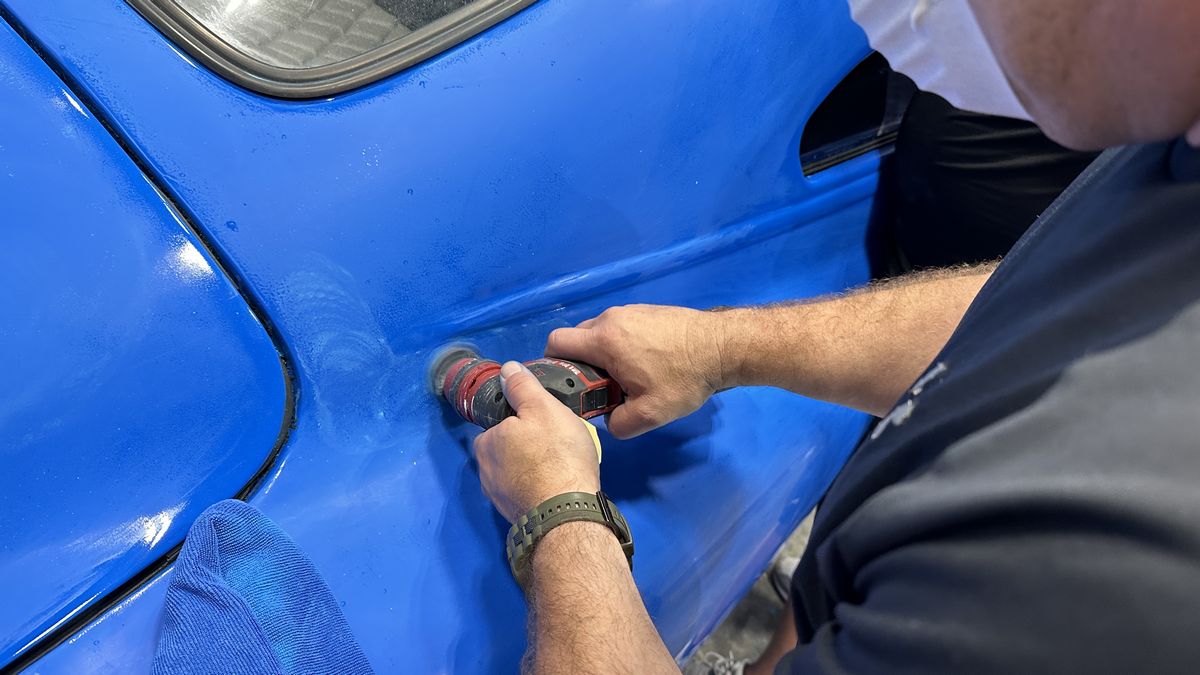

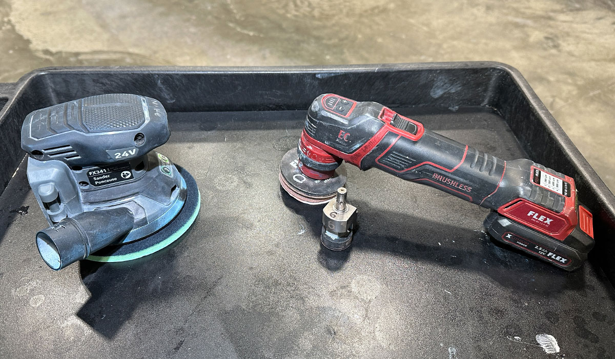

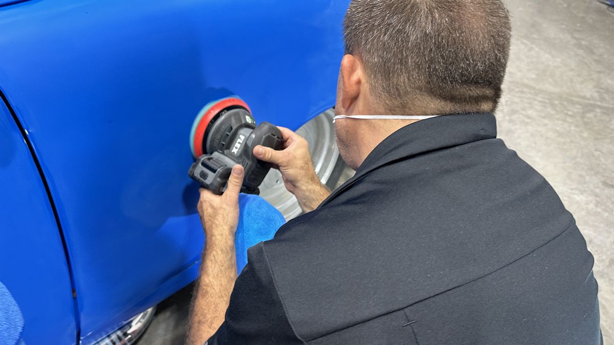

Machine Dry Sanding

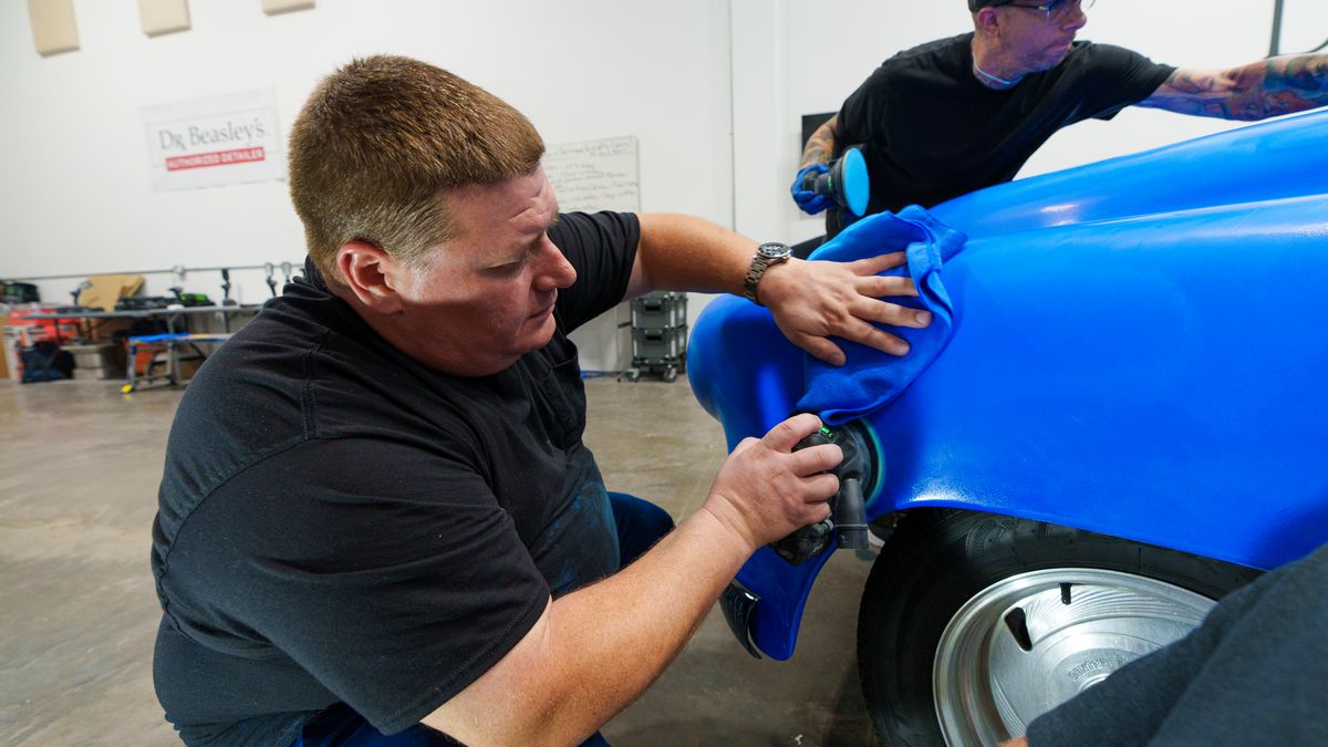

It's now 11:30am, the hand sanding portion is over and it's time to move onto machine dry sanding. For this the class is using the cordless FLEX FX3411 1.6mm 6" DA Sander as well as the FLEX PXE-80 with the optional 6mm drive unit. For sanding discs, the class is using the Eagle Abrasives by KOVAX 2500 Buflex Sanding Discs. The class is refining the 2000 grit hand sanding marks to further flatten-out and remove orange peel, dry spray and surface texture while also making it faster and easier to remove the sanding marks with the next step, using rotary polishers.
Here's Yancy assisting by showing how to center a sanding disc correctly onto an interface pad.
Continued....
Sanding is complete
After sanding the paint flat, the paint kind of look like matte or flat paint. This is normal. The next step will remove the sanding marks and restore gloss.

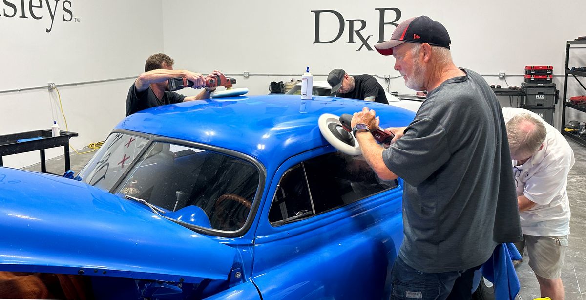

Using a Rotary Polisher to Remove Sanding Marks or Sanding Scratches
After the class has performed a 2-step sanding process, it's time to go back to the rotary and next remove all the sanding marks. First there's some demonstration on how to use the rotary with a wool pad and after that, I turn the class loose.

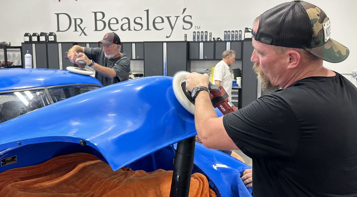

It's Rotary Polisher GO TIME!
This is just ONE of the reasons I START the students out the first day, first thing in the morning learning how to use and just as important, be COMFORTABLE with running a rotary polisher. When sanding and buffing some other dude's streetrod, you cannot make mistakes. By spending time with the rotary polisher on the first day for the Toyota Matrix and the Chevy Camaro, I can now have confidence my class knows what to do when it comes to removing the sanding marks out of this 1949 Chevy Fleetline Streetrod with a custom, single stage urethane paint job.
Work Clean
We put a LOT of stress on working clean when detailing cars and in this context, it means using a pad cleaning spur to clean your wool pad often.

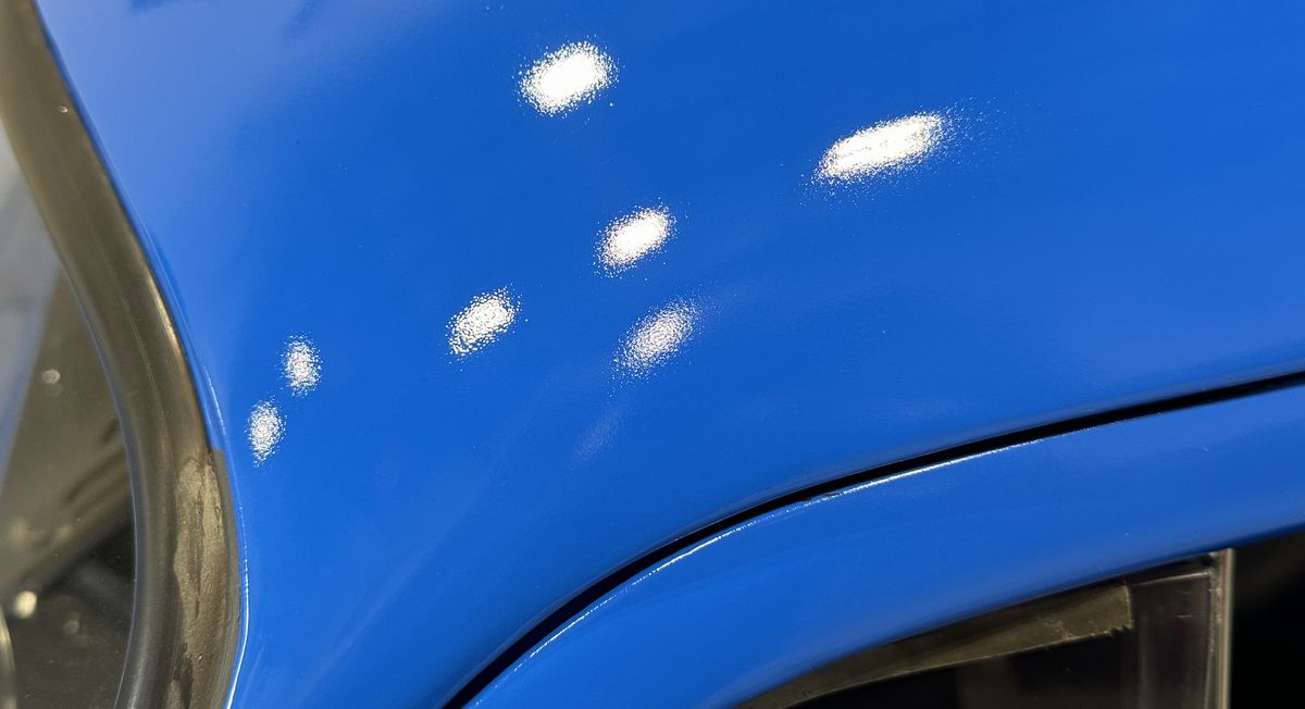

Look at the GLOSS coming back!

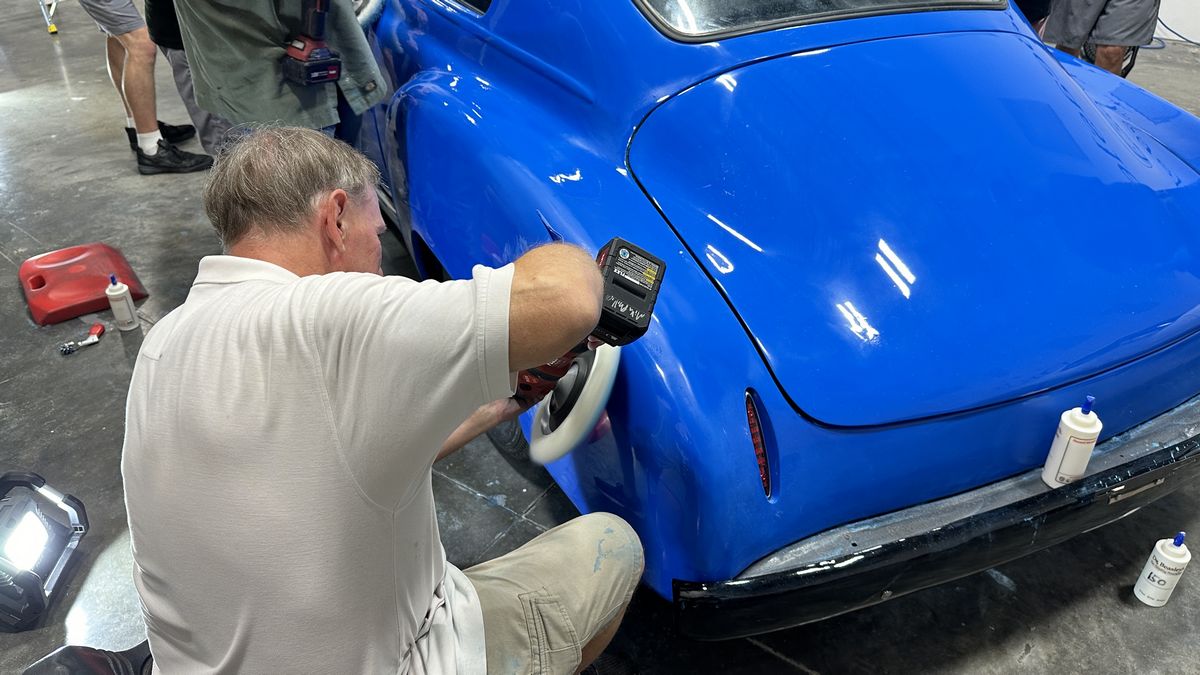

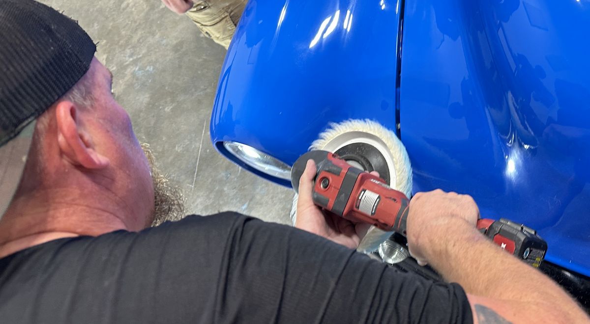

Cleaning up all the edges
It's a normal thing that after the class as buffed out all the sanding marks, I take over and make sure all the sanding marks next to edges and raised body lines are fully removed.

The first tool the class learned on the first day, first thing in the morning was the rotary polisher. This is a strategic plan on my part to get the class up-to-speed and comfortable with using rotary polishers so now, they know how to use this tool. Sure, you can remove sanding marks with an orbital or DA polisher, but the fastest and most effective way to remove 100% of the sanding marks is with a wool cutting pad on a rotary polisher and of course great abrasive technology. For this step, the class is using the Dr. Beasley's NSP 150 Primer.
There's an old saying that goes like this,
Use the right tool for the job
While some people are against the rotary polisher now-a-days, I simply believe you use the right tool for the job and for this kind of work, the rotary polisher IS the right tool for the job. And keep in mind, this is CUSTOM paint that is THICKER than factory paint. Thus, there's more film build for sanding, cutting and polishing.

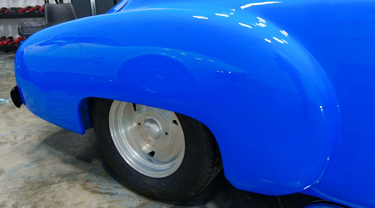

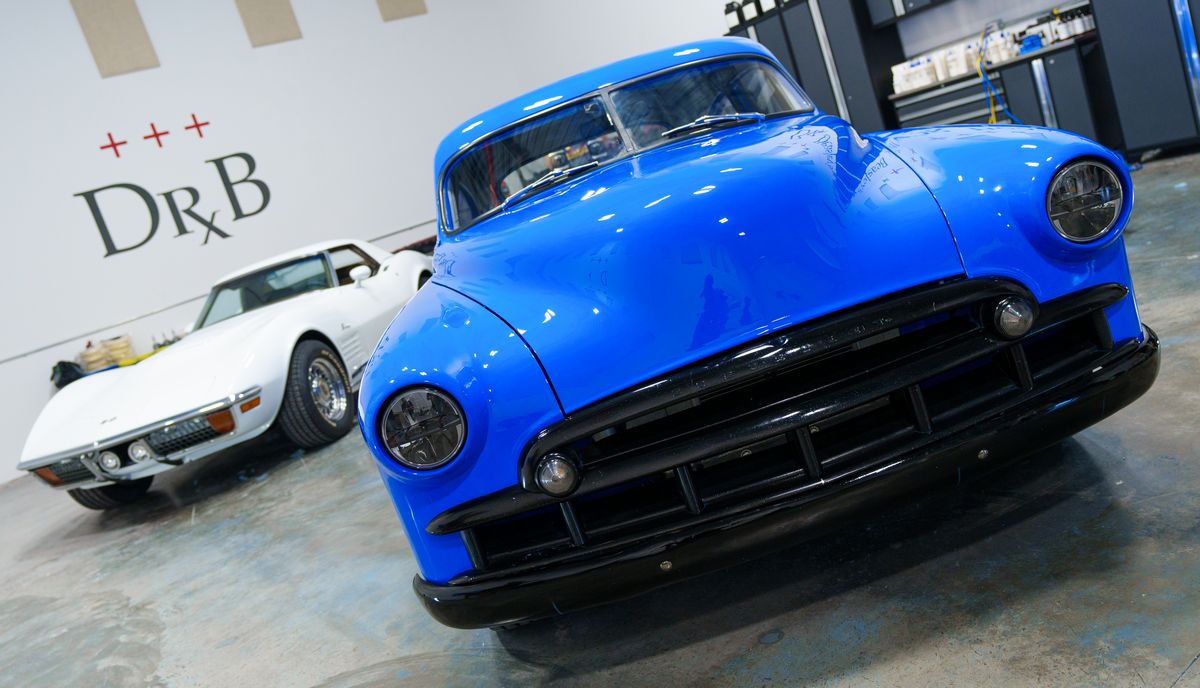

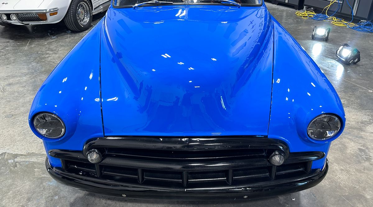

Final Results!
I highly recommend taking a moment to scroll up the page and revisit just how bad this paint looked before my class took over. The results you see below are nothing short of striking and dramatic!
See the 1972 Corvette Mirror Reflection?
Nice work everyone!
And now each of you completely understands what it means and what it will take to go from start to finish to buff out not a demo hood, or test panel, but the real-deal.
