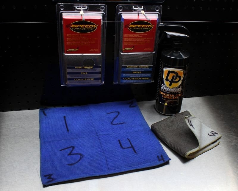

I saw in your video 500 + tips for beginners you were using a clay towel. It was the solid kind. I also have a clay towel. I have the sm Arnold speedy prep towel. I have the gray one which is the fine grade. I think they work fine.
Here's a video I made on the Speedy Prep Towel back in 2012 - Like the Nanoskin brand, this is a quality product.
Stay tuned for the tip at the end.
Also just to note - back in 2012 - that was likely an iPhone 3 I was using to shoot that video - so low resolution or low quality video capture and output.
Here's the matching article,
color=blue]How To Use the Speedy Surface Prep Towel[/color]
