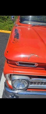

I'm looking for some advice on how to best tackle the paint on my 1960s Chevy C10.
The truck is a patina truck, not a restoration. From what I can tell, it has a mix of original single-stage red paint and older spot repairs/blend work. Various panels appear to have been patched and repainted over the years, with attempts made to blend the newer paint into the original finish.
The previous owners maintained it using the Penetrol/linseed oil method every few months. Because of this, the paint doesn't appear heavily oxidized despite being old red single-stage paint. However, I'm unsure how much of that appearance is due to the oils versus the actual condition of the paint underneath.

I would skip using the Comet Technique is there is NO visible, chalky looking oxidiation.
If the paint already has a clear/hard/shine - then the Comet Wash would be overkill.

Question?
Can you share some pictures? You can even text them to me and then I'll resize and insert them for you.
A good "front side angle shot" so everyone can see the actual truck and then maybe a few shots of the paint on various body panels.
