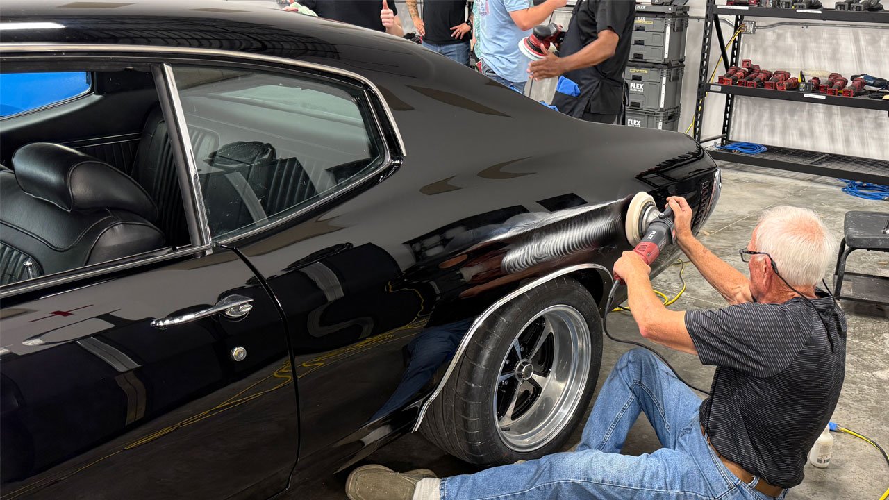

In the below pictures, I'm showing the class how to put a rotary polisher on edge to buff thin panels and intricate areas. NOT PICTURED are when I was showing a list of other techniques, including,
Let's get this Barn Find Party Started!
The first thing I like to teach is how to select the right speed setting and then use the speed setting lock button to lock the trigger in place. This enables you to place one hand on the head of the polisher and the other hand at the back of the polisher, which gives you the most leverage over the tool. Because I'm a huge fan of the cordless rotary polishers, I also show the class that besides providing you with the most leverage over the tool, by placing one of your hands at the back of the rotary polisher gripping the BATTERY - you then support the weight of the battery as you buff and this makes buffing a lot more comfortable on you plus the best control over the tool.
How To Buff Out Thin Panels
Buffing out the middle of the hood, a door or the roof is easy. Buffing out thin panels or intricate areas is a tick more tricky, so I simply share tips and techniques to make it both safe and easy on you.
You see me looking at a student answering a question, but at the same time I'm removing years of oxidation on the intricate shaped body panel that surrounds the threaded spline, where the wiper arms attach. I also shared the Dorman Windshield Wiper Arm Removal Tool to safely remove wiper arms off classic cars. These classes are literal brain dumps with 40+ years f buffing-out just about everything under the sun.
Fresh Air Grills - Classic Cars
And of course, after tackling the areas furthest away from me, next I hit the paint next to the tape that's protecting the fresh air grill. Later, I show how to buff out the fresh air grill so the paint on the ribs of the fresh air grill will be just as shiny as the rest of the paint.
Everything gets buffed on a Barn Find!
Sure the owner plans to replace the grill, but I shared how to buff out the oxidized aluminum grill, all the brightwork, like door handles and the chrome buffers. When it comes to a Barn Find, it's not like you can hurt anything, the car is already hurting.
- How to center a pad on a backing plate - most important thing.
- How to use the 10@10 Technique to pick up a strip or bead of product, which is a great skill to have for horizontal panels
- How to apply product directly to the face of the pad to buff out vertical panels.
- How to buff with the pad flat to the surface.
- How to buff by tilting the polisher and going-up-on-edge
- How to buff off an edge
- How to use a spur to clean your pad as you work around a car.
- How to edge a panel with an 8" wool pad - of course, feel free to use tiny 1" pads on microtools. Me? I make the tool already in my hand do what I need it to do.
